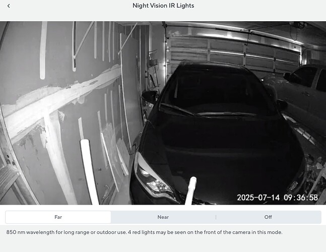

I only have v3 cameras, does the v4 not give you wavelength info for IR like the v3 does?
Not within the app, no. Cam v4’s UI differs significantly from the “old” Cam v3 UI. Cam v4 also has only single wavelength IR, not the “Far” and “Near” settings that you have with Cam v3. The product page says this:
IR Lights: 4x850 nm
