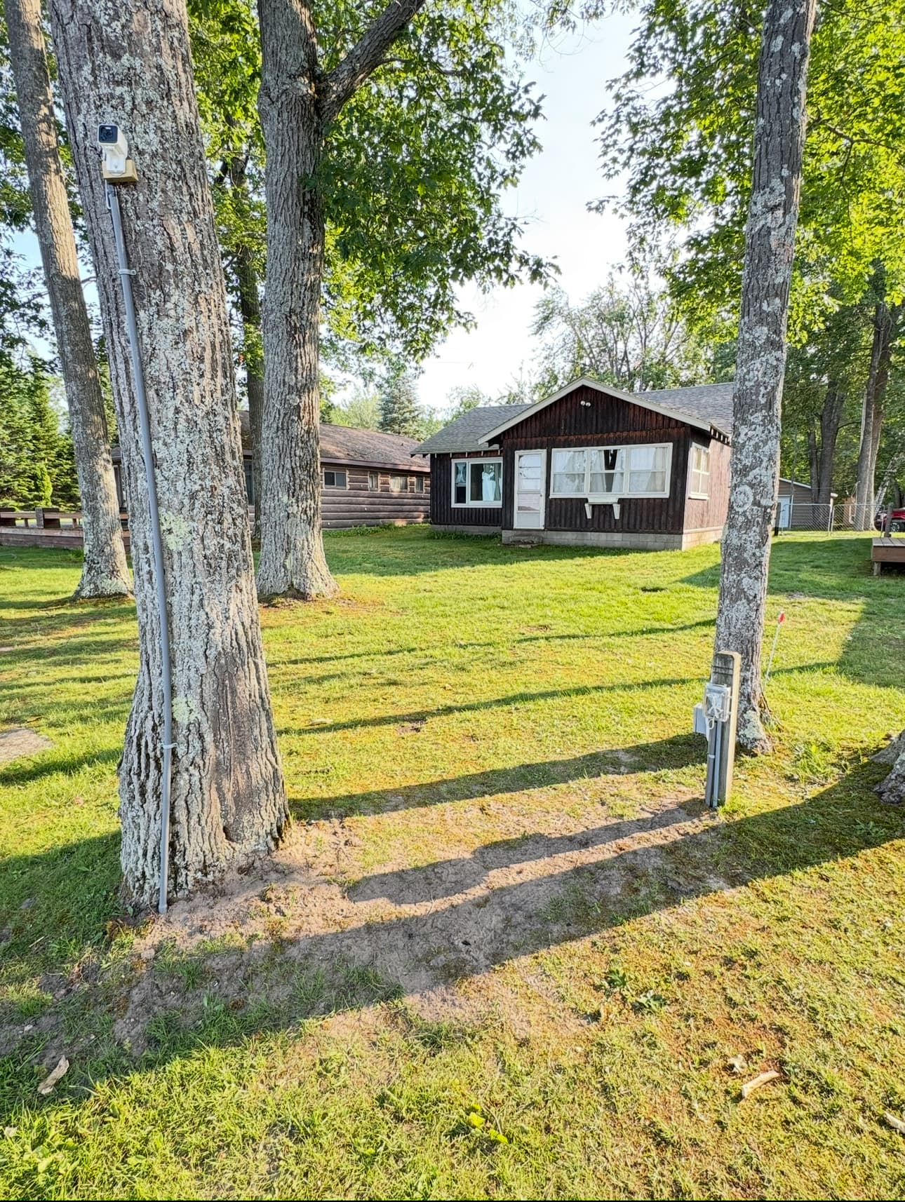

Here is our set up.
We buried the cord in conduit. Hopefully it will work through out our Cheboygan, MI winters. lol.

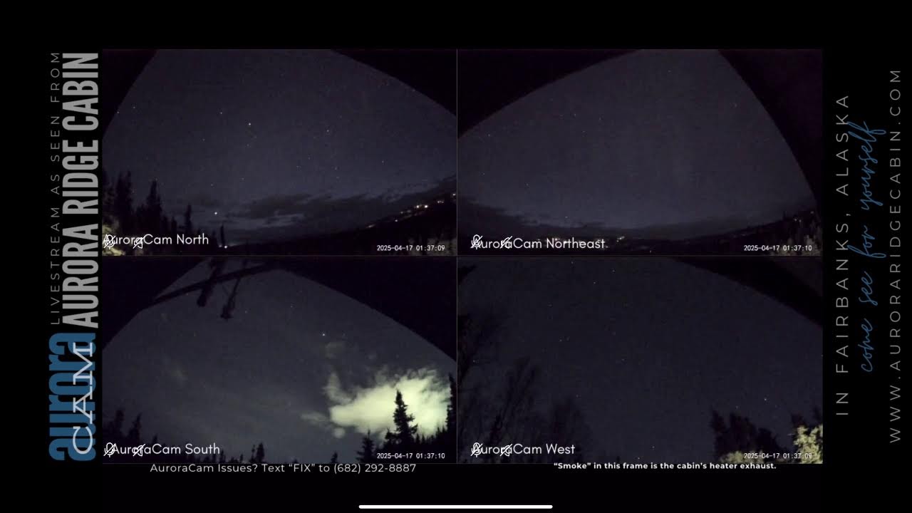

The Aurora Guy Vincent gave me the link for Aurora Ridge Camera to get an idea how the Wyze cams look. I contacted them via messenger and they said they use both V3 and V4 for their cameras and the V4 by far is more crisp and colorful. So I thought the V4 would better for my night shots. Again I can’t stand those vertical lines when it’s fully dark. Hopefully it will be better but I’ll have to wait a bit to find out.

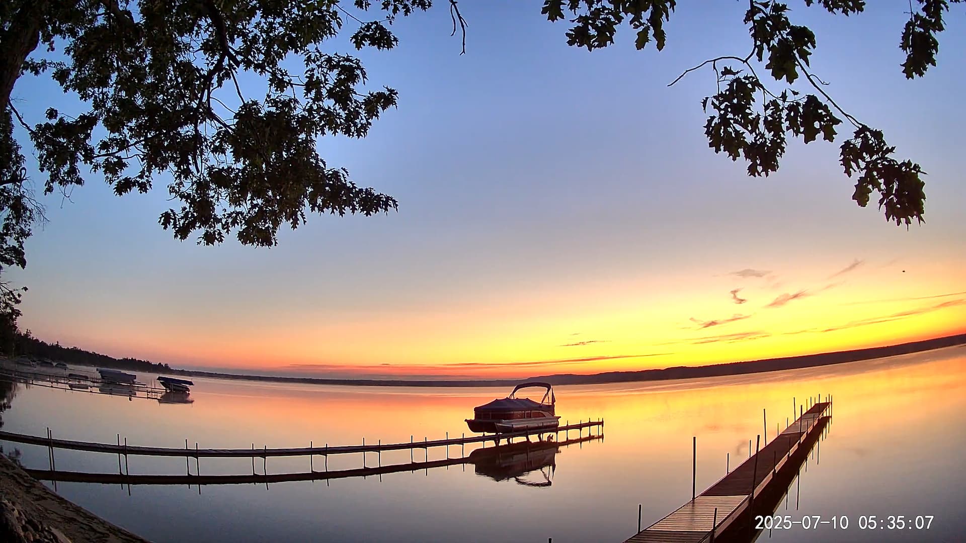

Sunrise with V4
I have not aimed my v4 at the sky, and the area it records has ambient light from streetlights, but haven’t ever noticed any lines in it, but I guess you’ll find out how it looks tonight. They will all have compression artifacts, just some have it better or worse, and I found the v4 to be the best of the ones I’ve tried, hopefully for your use case it will be too.
