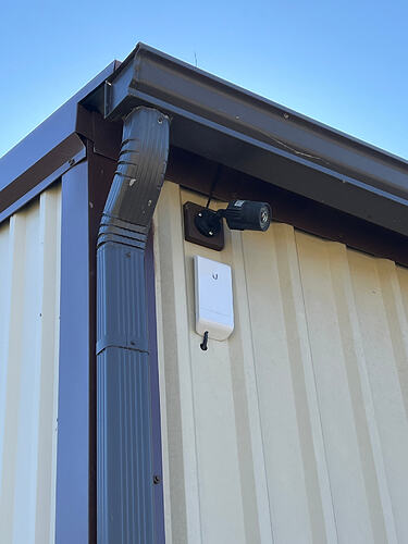

In case you’re wondering about the camera mounted above the Ubiquiti, I have 2 old cameras mounted at the top left and top right front of the shop. They are used just for extra IR lighting. With the Wyze camera (with IR) in the middle, I get really good invisible lighting covering a large area.

Glad it is working. Bit concerned about the hole the ethernet is coming out of, may want to loop the cable a bit and seal the hole to keep water out.
Yeah I know a few here are using spare/old cameras for IR purposes only. If you find your Wyze cam attracts too many bugs or reflects off rain when the IR is on, you can even disable its own lights and see if the others give you enough by themselves.
Did you get that front cam working too? I’m assuming that was unrelated to the shop wifi.
I will completely seal the hole today with quality silicone caulk. And probably make a drip loop inside the shop just in case. There’s not really anything below where it comes in. just a concrete floor and some old shop brooms.
