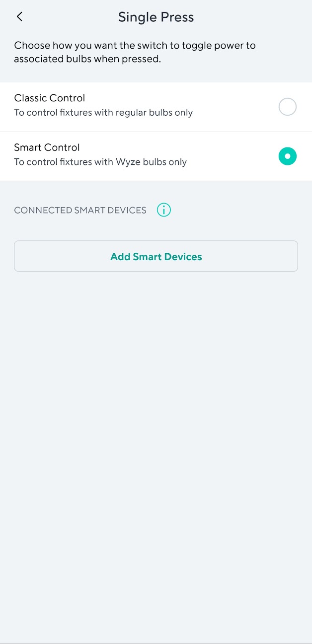

Can you post an image of your smart Switch Single Press setting?
To use the Single Press option, you need to make sure that it is in Smart Control and not Classic Control.
In addition, the automation you would want to set is to trigger on the Switch is on and then set the action to turn on the plug. Then set another automation with the trigger for switch is off then the action would be to turn the plug off.

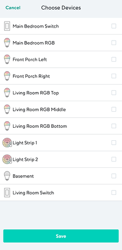

Certainly. Here are screenshots of my Single Press settings page, as well as the list of devices that can be added to that function:
Previously (I’m not sure how long ago, but at least at the time I installed the switch) I would have been able to select Wyze Plugs on this list as well, which is what I have been doing until now.

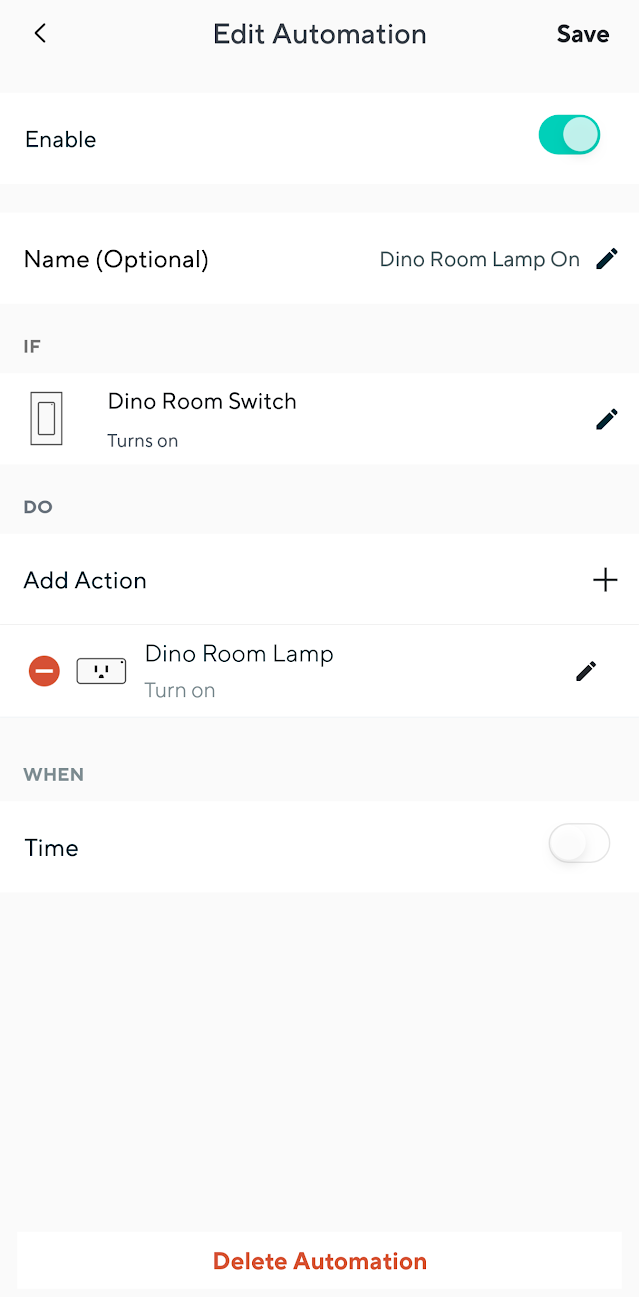

As I stated, creating a normal Automation (Plus button in top right corner of app → “Add Automation” → “With a device and/or service” → set desired switch as control device, “If Switch turns on” → add action “Do turn on desired plug”) does not appear to work. Nothing happens when the switch is turned on, and the Automation is not shown in the Automation History, which leads me to think it is not triggering at all.
I’ve never had any Wyze Switches, so I can’t confirm this myself, but I’ve been following your other topic and read what you wrote there about this. It seems weird to me that your “Choose Devices” screen actually shows other Switches (along with Bulb, Bulb Color, and Light Strip) but no Plugs (and I’d lump Plug Outdoor into this, too, because that’s often a more convenient option for controlling indoor things).
If I understand what “Smart Control” is supposed to do, then a single press of the Switch in this mode is supposed to act merely as a toggle (i.e., change the state from “on” to “off” or vice versa) for the selected Wyze device(s). Is that correct? If so, then this should definitely apply to Plug and Plug Outdoor in addition to Wyze lighting products, especially if it’s already applying to other Switches!

Yes, you understand what single-press Smart Mode is supposed to do on the Wyze Switch, be a simple toggle. The other “Additional Controls” are for more advanced actions, which I certainly understand. I even understand putting other Switches in the list of options to be controlled, because it means you could set up multiple switches to control lights consistently (For example, Switch 1 turns on Switch 2 and a light, then you can turn off Switch 2 and it will then turn off the light and Switch 1, kinda a replacement for a 3-way switch setup only “smart”). And this is how it worked since I installed the Switch, a few years ago. The Plug was an option in the Smart control list, and it just worked as expected. But something has happened since then, I suspect Wyze removed the option deliberately (rather than it being a bug) because the language in the app page for Wyze Switch Single-Press only mentions bulbs, nothing else.
